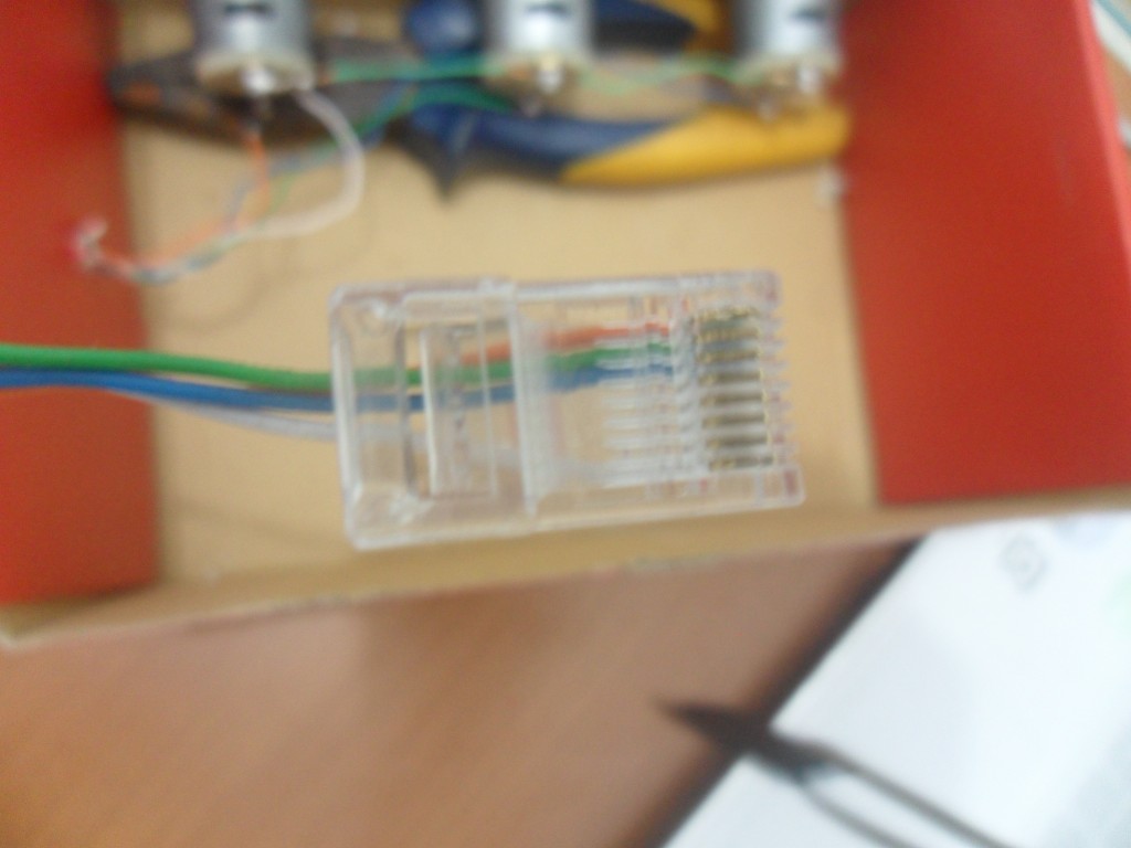

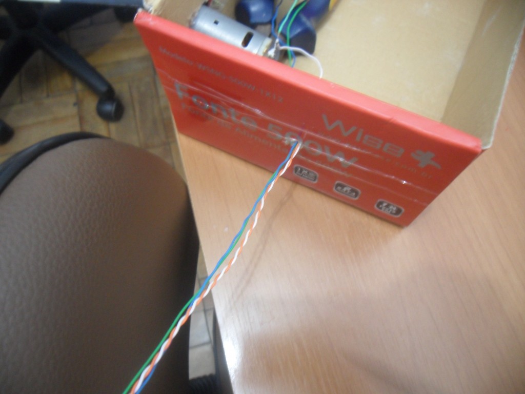

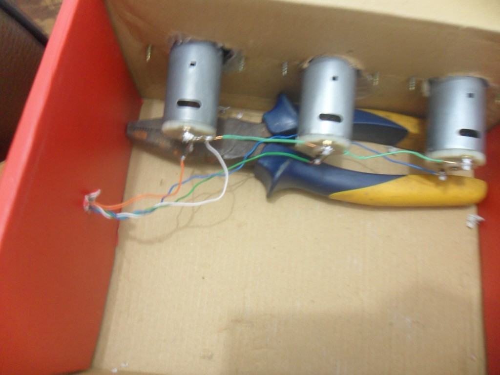

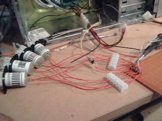

Your wiring for dosing pump can be more simple.
Put the diode directly on motor.
See how I did the wiring for my tests.
Ps. Add images bigger to your albums please. If you have difficult the convert images try a program called "Format Factory" and select the max. resolution to output as 1024 x 768. The image have good quality and small size (in bytes).
