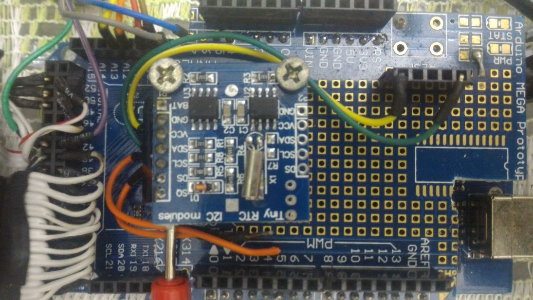

I seen your image in gallery and I did two advices.
1 - This RTC is not compatible with Henning's library because has an EEPROM on board;
2 - The SDA and SCL should be 18 and 19 or 20 and 21 because the pins 4 and 5 are for touch screen.

Thank you for seeing my gallery this problem I would treat after.
Which library should I use?
The orange wire is not connected to pins 4 and 5 he is not installed, however the picture looks.

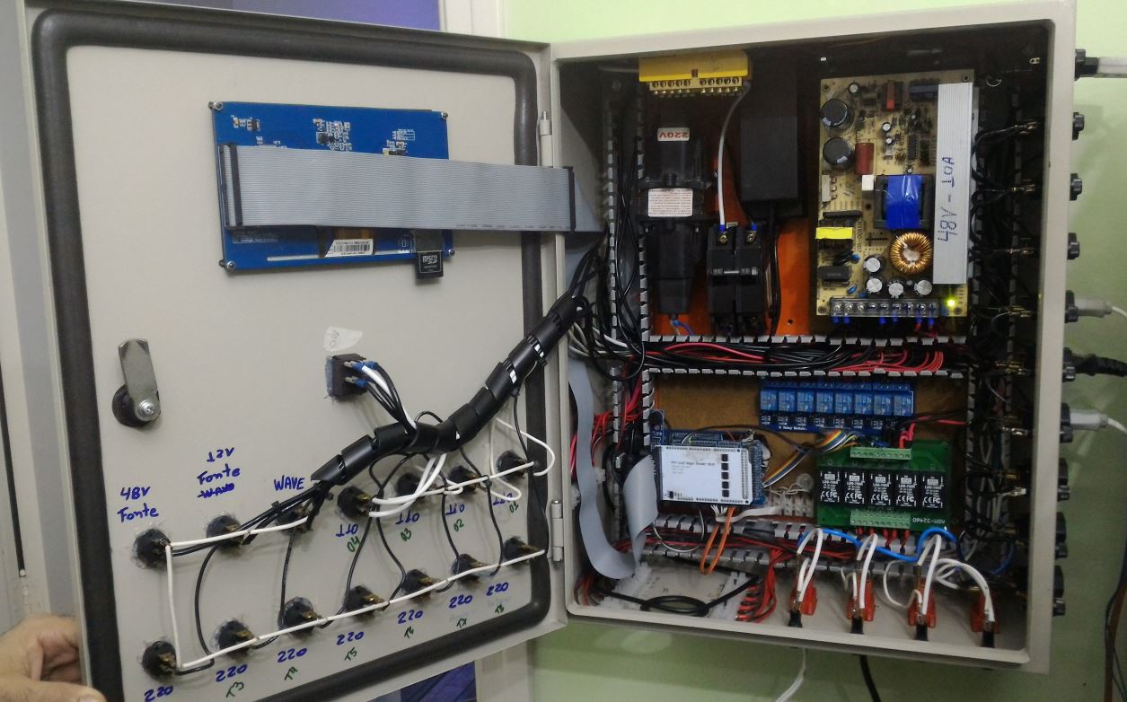

See my flat cable.
This face input in touch screen
This face input in TFT shield
I created this flat cable.
The problem may be occurring because:
- The cable is long?
- The cable is passing behind the power cables?

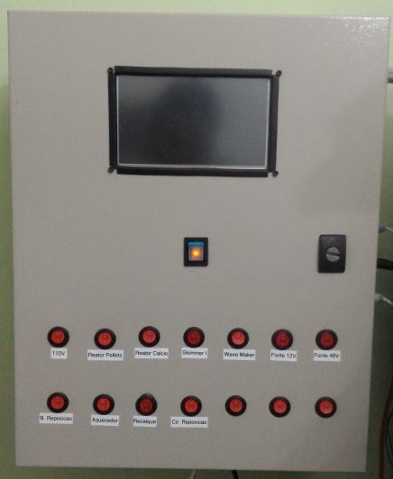

See my controller so you can better understand.
Outside
Inside
Video with problem
Watch on youtube.com
Post Number:#6 Post Fri Jul 22, 2016 11:47 am
Yes, the cable seems very long.
Cut out this remnant to decrease the length.
