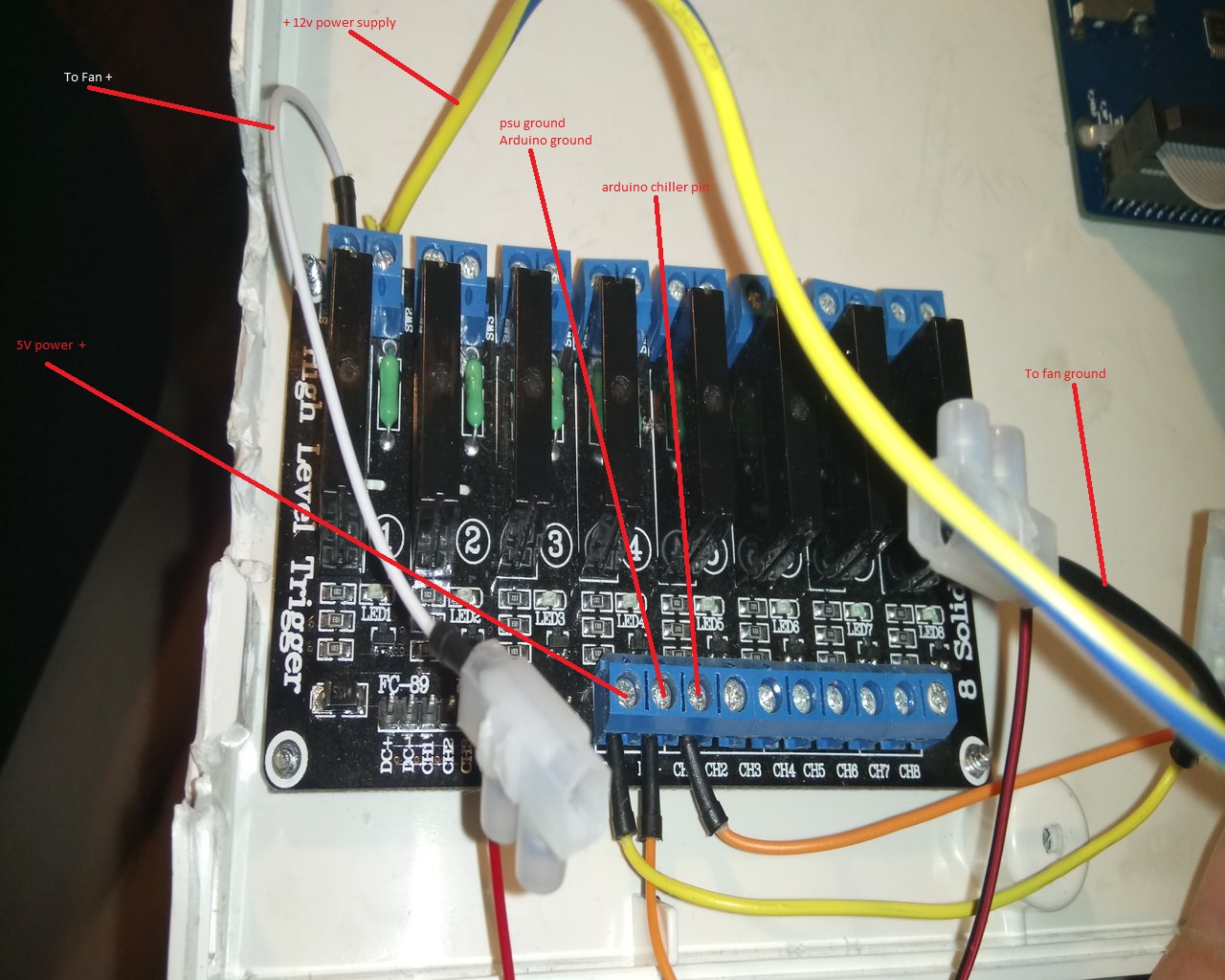

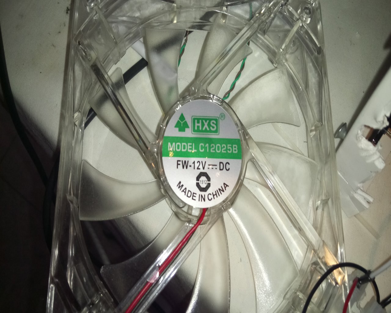

I also have a problem with the ssr. I'm trying to test chiller function. When the chiller function turns on the fan i connected doesn't turn on. when i disconnect the + cable and connect it again it turns on. When the chiller function turns off the fan doesn't turn off. When i disconnect the + cable and connect it again it turns off. What is going on?
1 - Test the circuit first with a blink;
2 - Show me the circuit;
3 - Which type of fan are you using?.

According to datasheet the total current on pin 8 can be 2.5A more than your SSR (2A).
So you can use 2500 / 7 = 357 mA per pin.
Are you using 5 V from Arduino to supply this relay board?
I think this SSR can't work with DC since it has a resistive fuse. Try with AC load.

Yes the SSR can't work with DC. I connected to 220V AC and worked.
