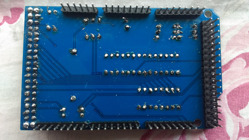

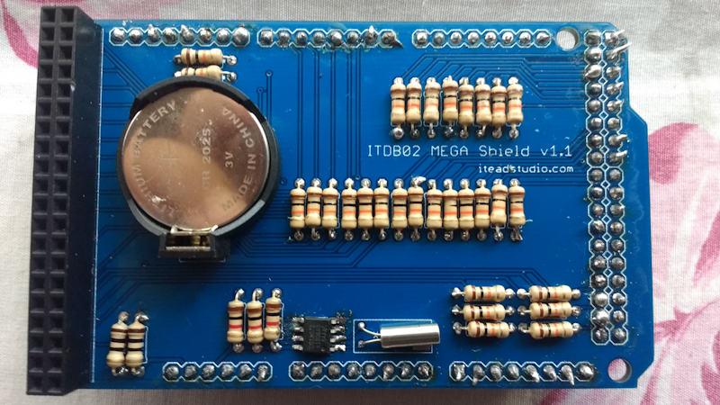

Hi Fernando,
Below are the photos of my TFT shield.
I don't find test code for SD card...could I show me ?
Rômulo Queiroz
Post Number:#10 Post Thu May 31, 2018 5:25 pm
You has bad soldering is top right corner.
viewtopic.php?f=8&t=42

Fernando,
I have refaced the welds of the board but continue the same message of INSERT THE SD CARD.
As for the test code of the SD card appeared a white screen and did not give any result.
Now I'm lost, what can I do? I do not know what else to do.
Rômulo Queiroz
