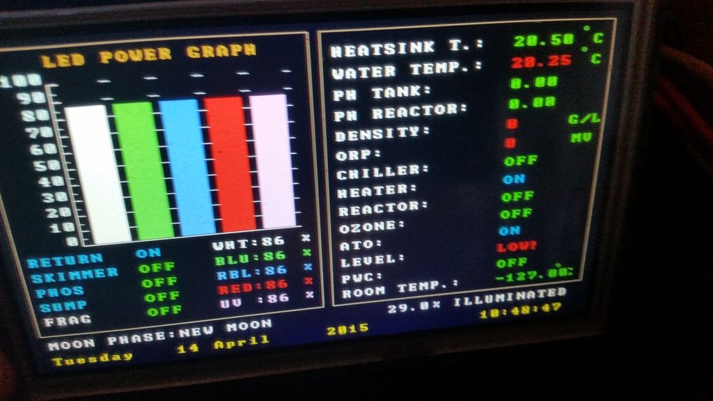

Done a rework of Willies 7.0" Screen code
Now have all the Joyreef working again .. Code updated to the latest Ferduino with Web control
Anybody need it just let me know

Post Number:#8 Post Tue Apr 14, 2015 10:55 am
Thanks for your job.
Can you send the pull request to Willie's Github or create an account for you?
