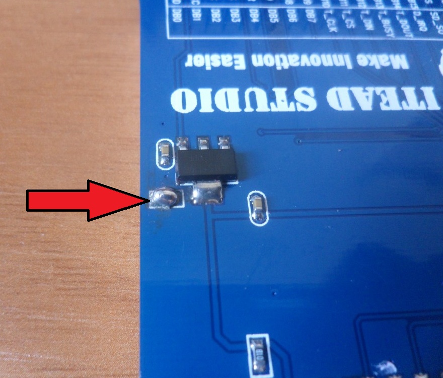

Post Number:#18 Post Thu Mar 05, 2015 8:27 am
Put this lines on code again to make sure that the program can find the SD card.
  while(!card.init(SPI_HALF_SPEED, ChipSelect_SD)) // Inicia a comunicação com o cartão SD.
    setFont(LARGE, 255, 0, 0, 0, 0, 0);
    myGLCD.print("PLEASE INSERT A SD CARD.", CENTER, 115);
    Serial.println(F("Please insert a SD CARD"));
Try add a shunt on pad called J1 on bottom side of TFT. Like this:
Try change:
 SPI_HALF_SPEED
To:
SPI_FULL_SPEED
Or:
SPI_QUARTER_SPEED
Try other SD card.
