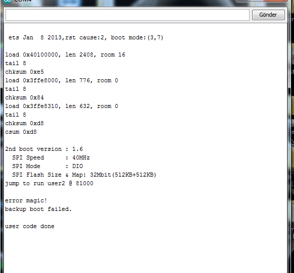

Serial gave the same text on the monitor. The problem has not changed.

The problem persists.

In this point I can't guide you step by step. You have to search for solutions on Google since this is not a problem with Ferduino code.
Try install an example like this using Arduino IDE.
If examples are working so try install ESP-link again.
Also you can try the latest version of ESP-link from here.
If the magic error remains so try search a solution like this in ESP8266 repository.
Otherwise you should buy another NodeMCU.
Moreover you should test the NodeMCU alone just connected to USB to make sure this is not a wiring error.

the system repeated the same error.

I cannot use the 5 - 3.3 V logic level changer. I just connect Arduino and esp8266 so the system might be giving an error?
5 - 3.3 V logic level do you need to buy this module?
Post Number:#53 Post Sun May 31, 2020 5:10 pm
Obviously it's needed for this reason it's listed here.
You will damage your ESP connecting it directly to 5 V.
Moreover....
