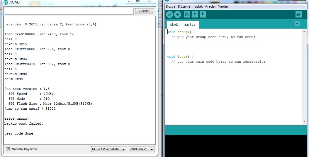

After open monitor serial your should press the reset button.
If there's strange chars then change the baud rate to 74880 to see bootloader messages. It's something like this:
 ets Jan  8 2013,rst cause:1, boot mode:(3,7)
load 0x40100000, len 25336, room 16
tail 8
chksum 0x1f
load 0x3ffe8000, len 2544, room 0
tail 0
chksum 0xb8
load 0x3ffe89f0, len 1044, room 8
tail 12
chksum 0x7f
csum 0x7f
Post Number:#31 Post Mon May 11, 2020 8:08 pm

It came as you said yes. I changed the Baud Setting. I apologize from you.
gallery/image.php?album_id=72&image_id=711
Post Number:#32 Post Mon May 11, 2020 8:11 pm
Sorry I can't see your image.

Post Number:#36 Post Mon May 11, 2020 8:26 pm
Oh! Very good! Now I can see your image.
Try erase all memory using this files then install ESP-link again.
