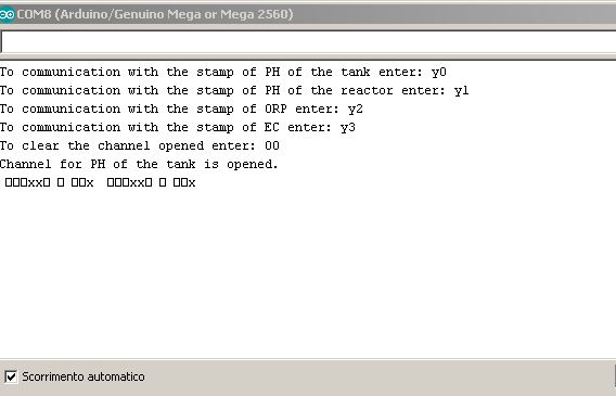

Hi Fernando,
waiting for the next Tank I'm trying out the various features of Ferduino. So amazing!!
I bought the ph stamps of atlas scientific, the multiplexer and the iso board.
I connected everything like this:
multiplexer
in RX >>>> 14 TX3 (arduino)
in TX >>>>> 15 RX3 (arduino)
S1 >>>>>>>> 16 TX2 (arduino)
S2 >>>>>>>> 17 RX2 (arduino)
S3 >>>>>>>> GND (arduino)
EN >>>>>>>> EMPTY
VCC >>>>>>>>>> 5V (arduino)
GND >>>>>>>>>> GND (arduino)
iso board PH0
RX >>>>>>> P1 TX
TX >>>>>>> P1 RX
VCC >>>>> 5V
GND >>>>> GND
with the test code for stamp, by enabling the channel, I read some strange characters
as shown in the photo.
I tried the stamps with the code provided by atlas scientific and found the correct values.
can you help me?
regards

maybe solved! I changed the baud rate to 9600 on the test code and read the values perfectly.
I have not tried with ferduino yet
thank you!

Juan, I don't understand your comment. Are you working together with Gio?
-------------------------------- Last edited Thu Jan 24, 2019 9:47 am --------------------------------
Gio, connect EN pin to GND.
Please show me a picture of your circuit.
About baud rate follow this instruction:
viewtopic.php?p=2280#p2280

hi fernado,
it's my fault.
Juan Carlos is helping me with a board that I designed and today using his pc I did not realize that I was using his account.
it was he who introduced me to ferduino
sorry for the confusion created
about the multipexer I changed the baud rate to 9600 in the ferduino code and would seem to work.
Post Number:#5 Post Thu Jan 24, 2019 2:38 pm
The communication will spend more time.
Change the baud rate of your stamp it wil be done just one time.
