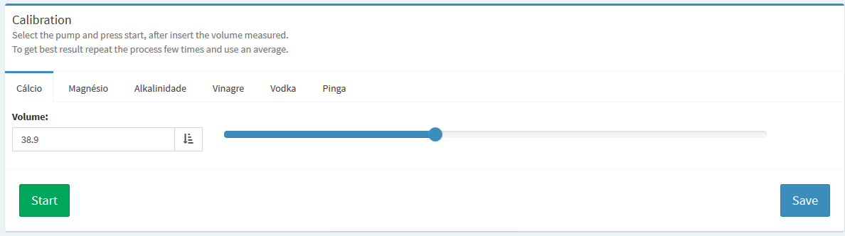

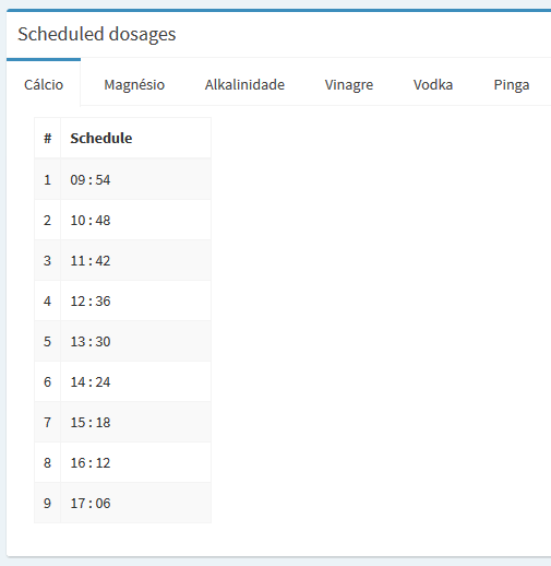

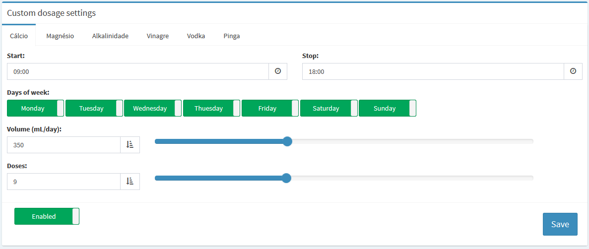

Example:
The interval between dosages is 54 minutes because the time is divided in equal parts.
To find the calibration I did: 350 ml / 9 = 38.9 ml

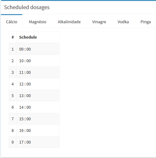

Subtracting 1 hour on start time the schedule will be:
