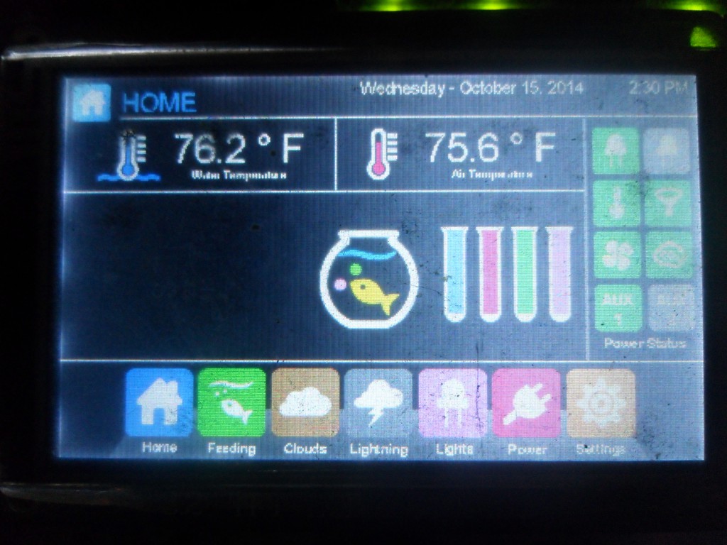

Post Number:#6 Post Sat Jun 25, 2016 12:42 pm
It worked to me.
Ferduino tab:
L_Menu tab:
Result:
I'm using images from iAqua avalaible here.
