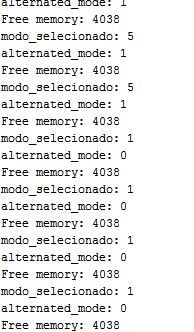

Post Number:#9 Post Sat Jun 04, 2016 6:20 am
Len Nederlof Random avatar
Hi,
I understand thats not the best solution becaus I lose 2 modes.
I tried and tried. I even started with a new sketch and tried again.
If I use your example the wavemaker starts and altenated mode is "true"
than automatic mode switch automaticly to mode 1 alternated mode switch off.
I think this is correct because to stop the interchange you need to select a mode between 1 and 4 and this is done by the program
Here is a screenshot of the serial monitor.I only selected mode 5 and run the serial monitor
Kind regards
Len
Post Number:#10 Post Sat Jun 04, 2016 10:32 am
Show me the full code please.
