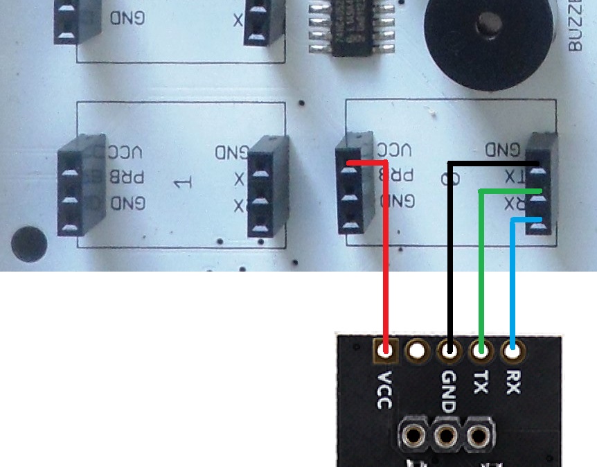

Just for my understanding, if we could use the isolated carrier board from Atlas, which could be the wiring?
in that case the multiplexer should not be removed from ferduino, right?
Post Number:#8 Post Mon Jan 15, 2018 3:00 pm
Just connect like this:
Don't remove the multiplexer.
