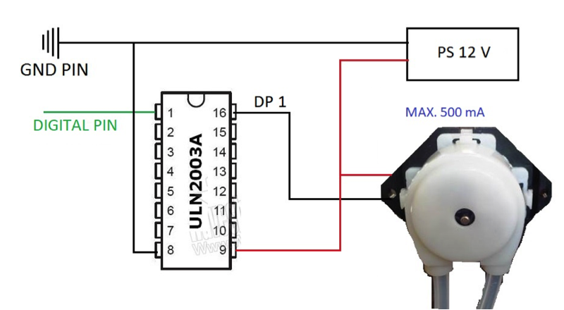

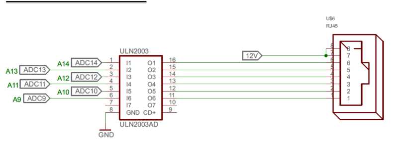

Good morning, which circuit is recommended? The one used in Mega 2560

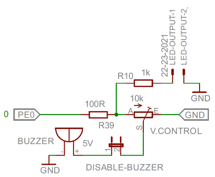

or the one in the circuit post
and as I have seen in some posts, the next circuit for the alarm is recommende
instead of the one used in Mega 2560
Greetings and many thanks
Post Number:#2 Post Wed Sep 20, 2017 9:36 am
This circuits are better:
