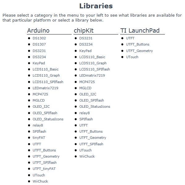

What is the libraries I need to download?
Post Number:#10 Post Wed Oct 28, 2015 8:18 am
Posts: 275
Topics: 6
Images: 46
Topics: 6
Age: 44
Location: Byers
Utft and utouch
Happy reefing to all.

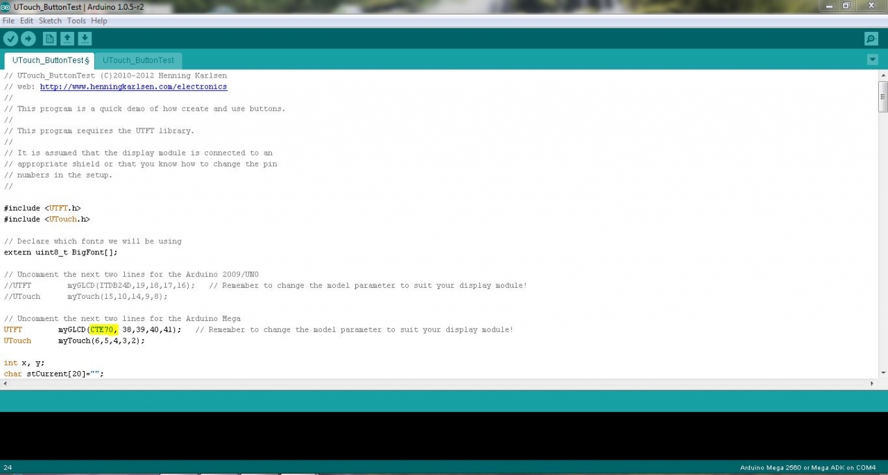

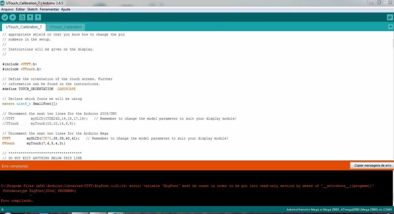

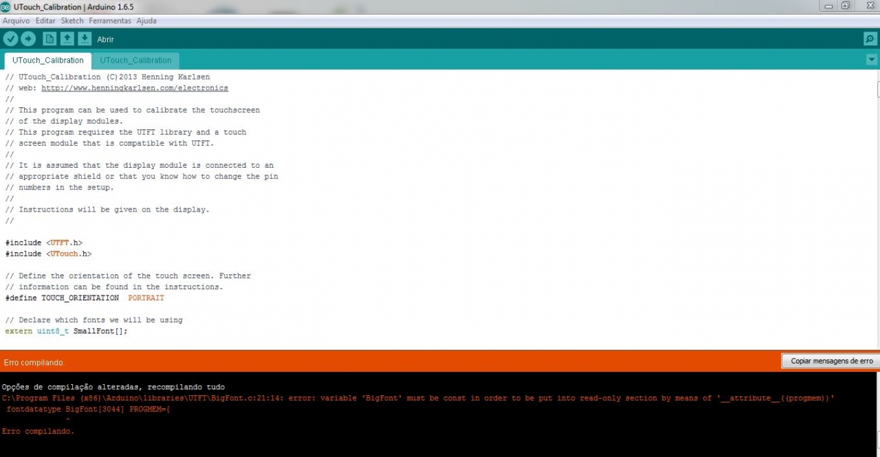

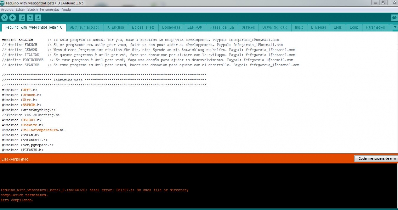

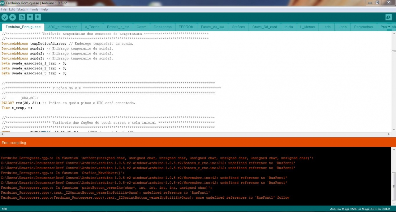

Hello Guys
I downloaded the all file from Willie.
But I didn't have success, because the code have "error"
Started with calibration but error
I try to change the code CTE70 and pins 7,6,5,4,3 but error
And other try I put de complete code, but error
Post Number:#14 Post Wed Oct 28, 2015 9:49 pm
1 - I told here 1 TON of times to use IDE 1.0.6.
2 - The pins for touch are 6,5,4,3,2.

Post Number:#17 Post Thu Oct 29, 2015 8:58 pm
Use UTFT library downloaded with Willie's code.

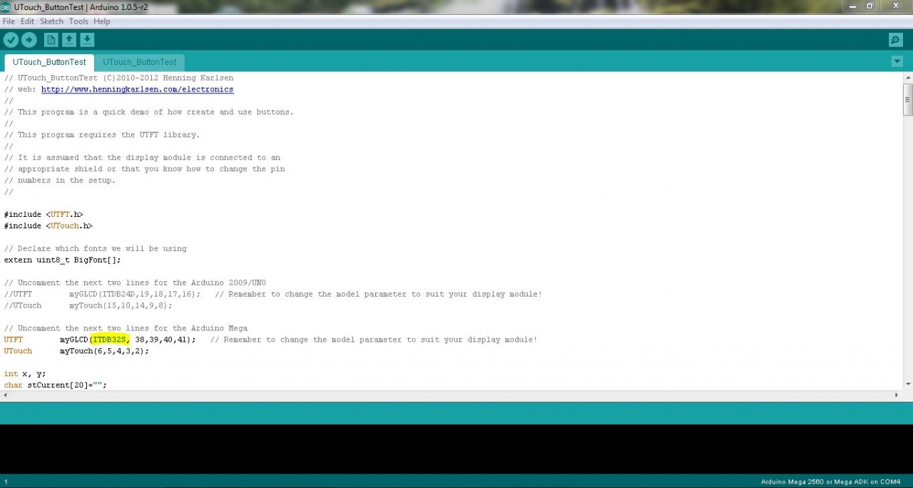

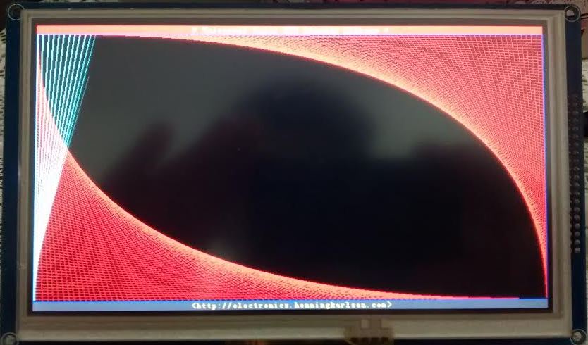

Hi Fernando
Today I'm very happy :D :D because I had my first success. But only one!!!! :| :|
I could calibrate the TFT and execute the examples "UTFT_Demo_800x480".

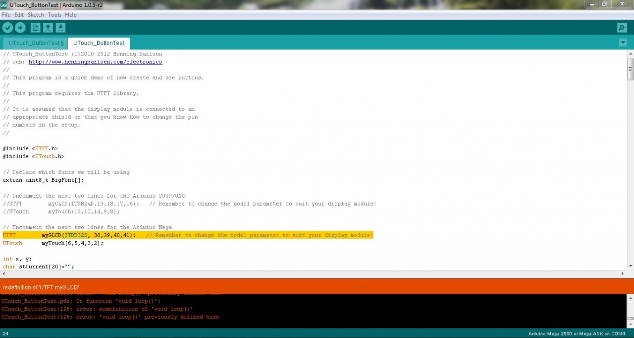

After then I tried UTOUCH_Button Test, but the TFT code was ITDB32S,
So I changed it to CTE70 and request verification
The Arduino changed CTE70 for ITDB32S and some errors
Could you help me?
PS: All the test I use Willie's code
Post Number:#19 Post Sat Oct 31, 2015 11:06 am
Are 2 tabs with code equal opened. Close one.
