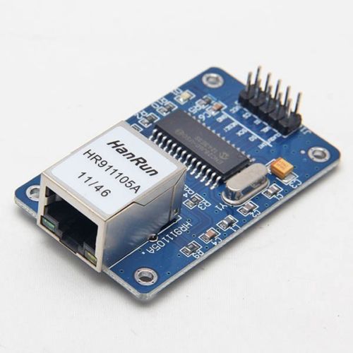

i have this module
you say :
"No changes are required.
To prevent conflict between SD card from TFT and SD card on ethernet shield, you must remove pins 50, 51, 52 and 53 of the TFT shield."
I do remove this pin or not ?
If i remove this, my sd card reader dosen't work.
sd card are not compatible with ethernet module ?
"S0,S1,SCK is a bus and all device are in parralel ?
Thank you
Post Number:#4 Post Mon Jun 09, 2014 8:08 am
If you have this module, you'll need of the SD slot on TFT.
So you can't remove pins 50, 51 and 52 from TFT shield.
The interface SPI (pins 50, 51 and 52) can be shared with many devices, only the Select Slave need be different.
If you made the bridge between the resistor and the pin 4, you'll have pin 53 as SS to the ethernet module and the pin 4 to the SD card.
