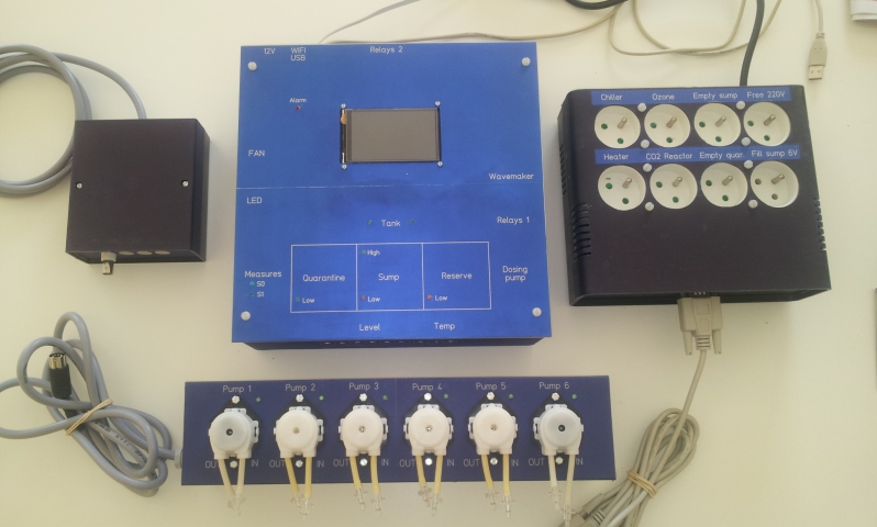

Hello Fernando,

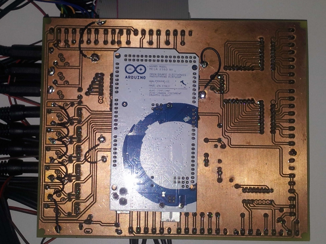

Here 2 pictures of my ferduino PCB (sorry for the poor quality).
Dosing pump
PH stamp
Float switch
Working correctly
Relays 1 and 2
LED
Fan control
Not yet tested
Once again thanks for your help
Best regards,
Jean-Yves

Great job!
I think that someone is trying copy my Ferduino Mega :D
Do you are using the version with web control?
Can you tell me where found this float switches with long cable and temperature sensors with plastic isolation?

Fernando,
No panic it's impossible to make a copy as perfect as your board.
I only did it for myself to simplify all the wiring.
I have to add that it's far away from the quality of your board but as I follow your project since the beginning I had all the required components that are now integrated in Ferduino board.
I am using Joy-reef but the function has not been tested with the board because I use an ENC28J60 as ethernet shield and I have ordered a W5100 to try with the new version of webcontrol.

You'll add some material to protect the copper surface of your board?

Yes I will protect the circuit with special varnish but I have first to modify the buzzer circuit ( don't know how ) that was made following the shematics provided in Ferduino Mega but I saw yesterday that there is a difference with the circuits in the forum.
Best regards,
Jean-Yves
Post Number:#8 Post Tue Dec 16, 2014 1:37 pm
Don't worry.
The circuit will work fine with trimmer of 10K.

Hello Diztly,

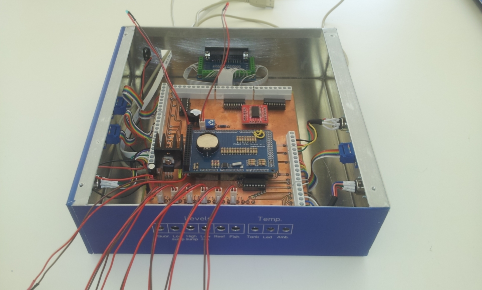

Here is a side view of the assembly
This board was made to mount the different shield on it (from bottom to top you have arduino mega, ethernet shield ,diy shield, ITDB 02 shield and the TFT LCD ).
Basically its is the same shield but more complete that the one Fernando recommends in the part list ( the green one ).

Some short comments on the pictures of my Ferduino.

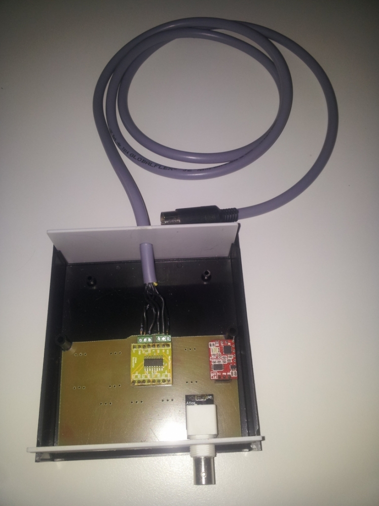

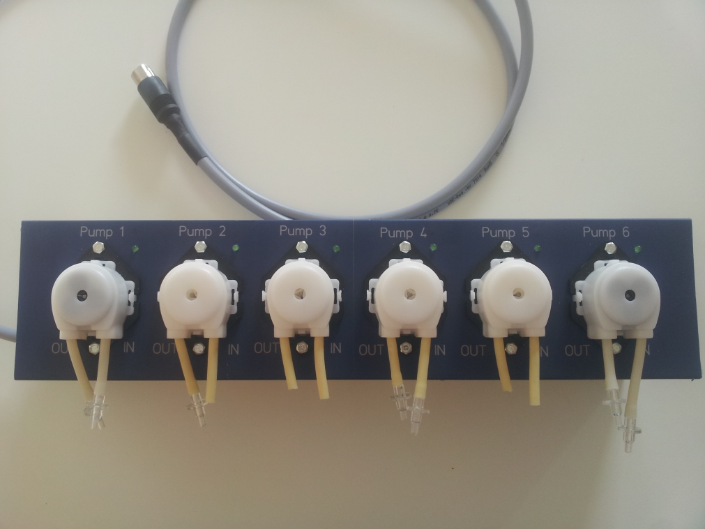

Stamps box
Inside of the box
Finished box

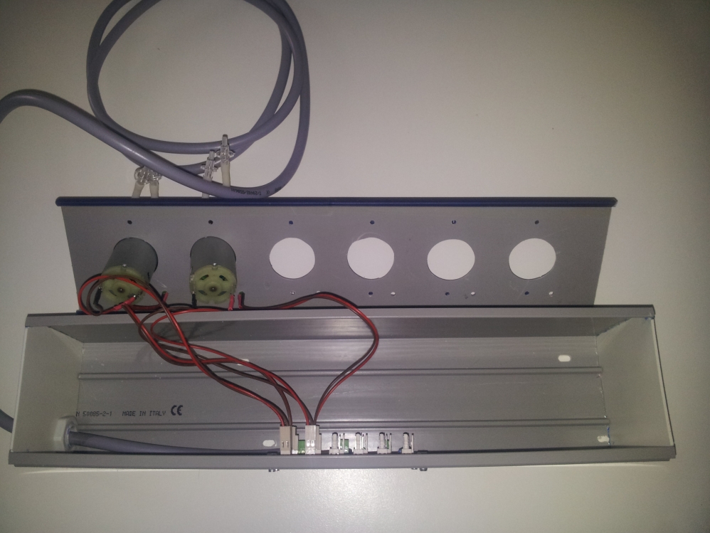

Dosing pumps box made from electrical trunking
All pumps installed
Box finished

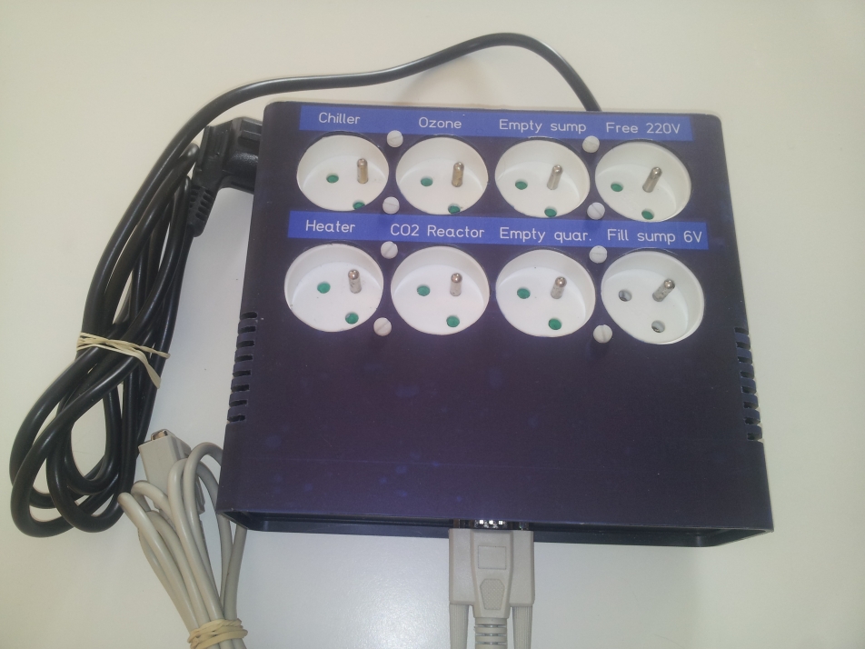

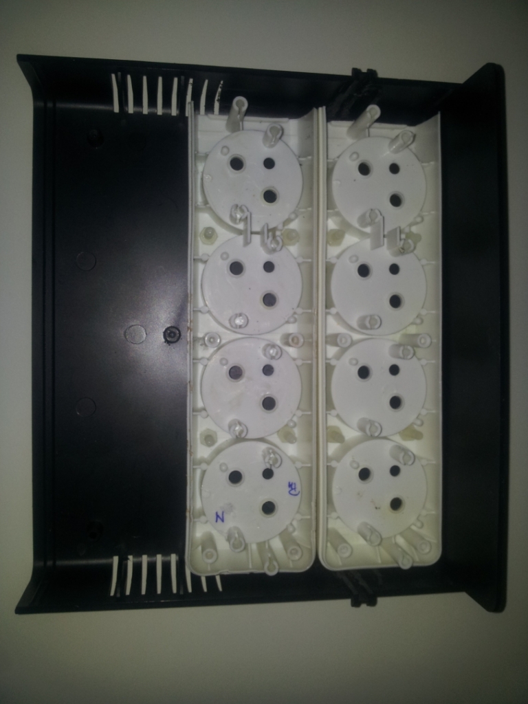

Relays 1 box
For this, I used 2 multiple outlet modified so that each outlet is independent and controlled by relay( except one which is always powered ).
Here the 2 multiple outlet fixed in the box

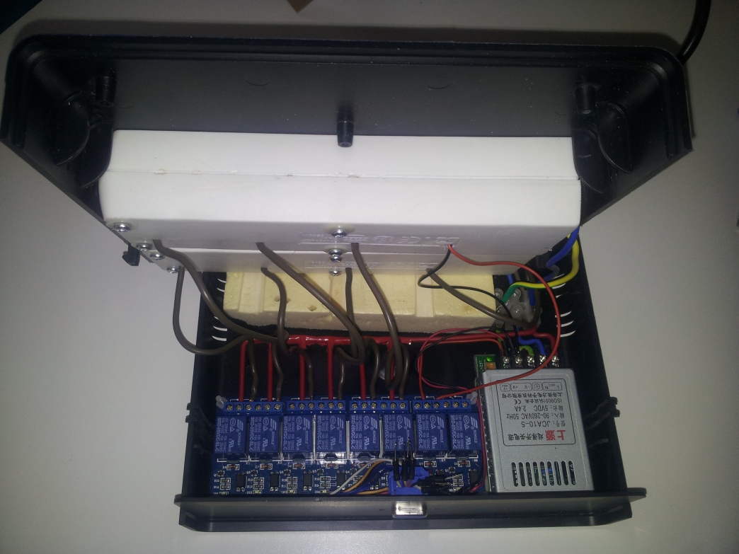

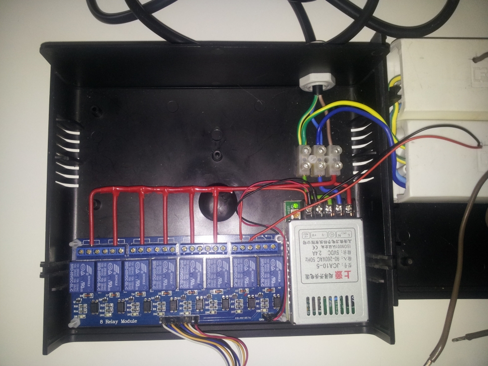

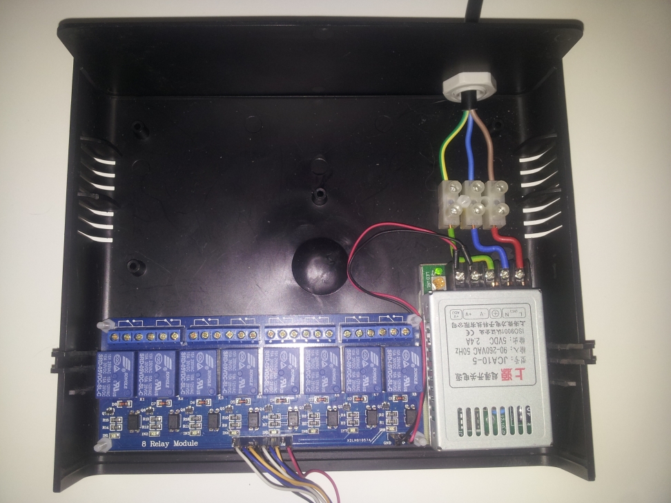

In the second half of the box,I fixed the relays board and the step down converter used to power the relays and the 6v outlet for the ATO pump.

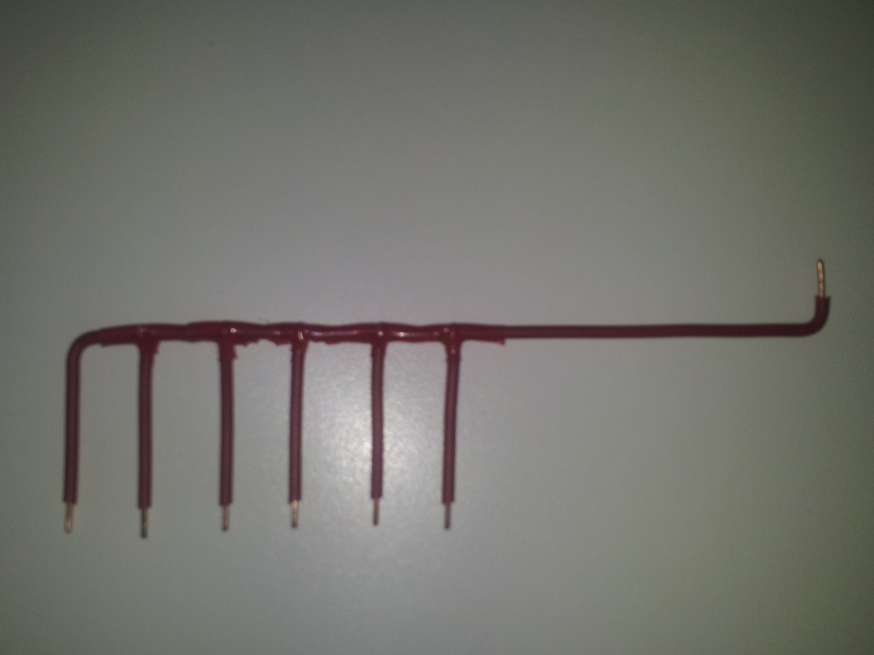

Hot wire for the relays
Hot wire installed
Just before closing the box with everything connected
Box finished

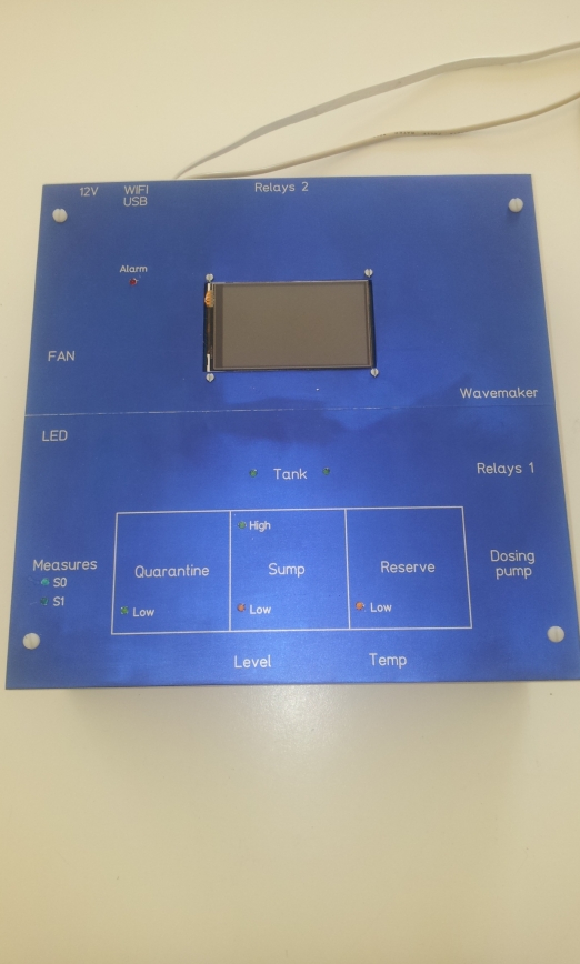

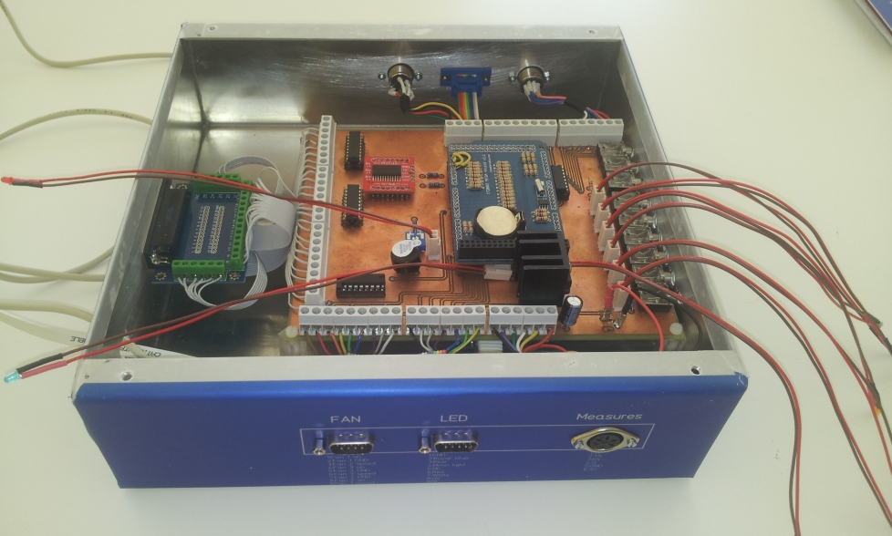

Ferduino box
Front view
Left side
Rear side
Right side
Cover
All together
Working Ferduino
Best regards,
Jean-Yves
