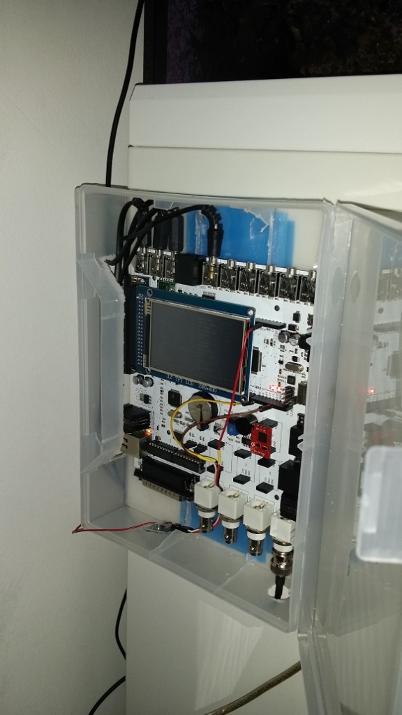

Everything is still working great. I added a ph stamp. I can now make my aquarium cooler fan run when it get's to hot. And i added a 433 transmit module to the ferduino so I can switch on my wireless power sockets in my home (klik aan klik uit). I can now switch on remote my hd-camera to have a nice life feed of my aquarium, and see if my flow pump is running. I am actually done now. Evertything is working exactly how i want it too. So what i have is:
3 temp probes running
1 ezo ph stamp running
1 cooler fan running when it get's to hot.
1 float switch that get's triggerd if my return pump stops (send an ph reactor alert to my e-mail)
1 433 wireless communication to power sockets that now controll my hd internet camera.
So fernando thank you for bringing this awesome product.

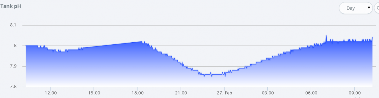

I will see if i can make some nice pictures tomorrow. I have one thing i would like to fix but it is just for the niceness of it. I still have a littebit noise on my ph readings (see picture or click link):
https://dyp.im/fIiN6fj5w9
The max of those reading is correct i testes this with my other ph measurement. So i would want to take say 10 readings and then only use the max of those 10 readings. That way I would filter out the noise. Any tips on how to go with that idea, or maybe you have a different idea?

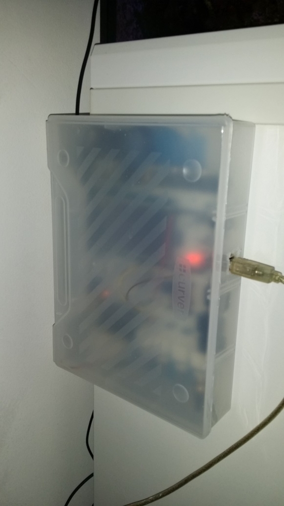

Here are some pics. I use a 3 euro curver storage box that i hacked up. cheap and splash water proof and easy accesible.

This is my ph curve after i made the change to the new code, much better :) .
