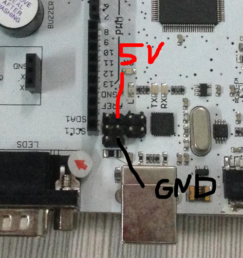

There 5 V and GND available on ICSP header.
