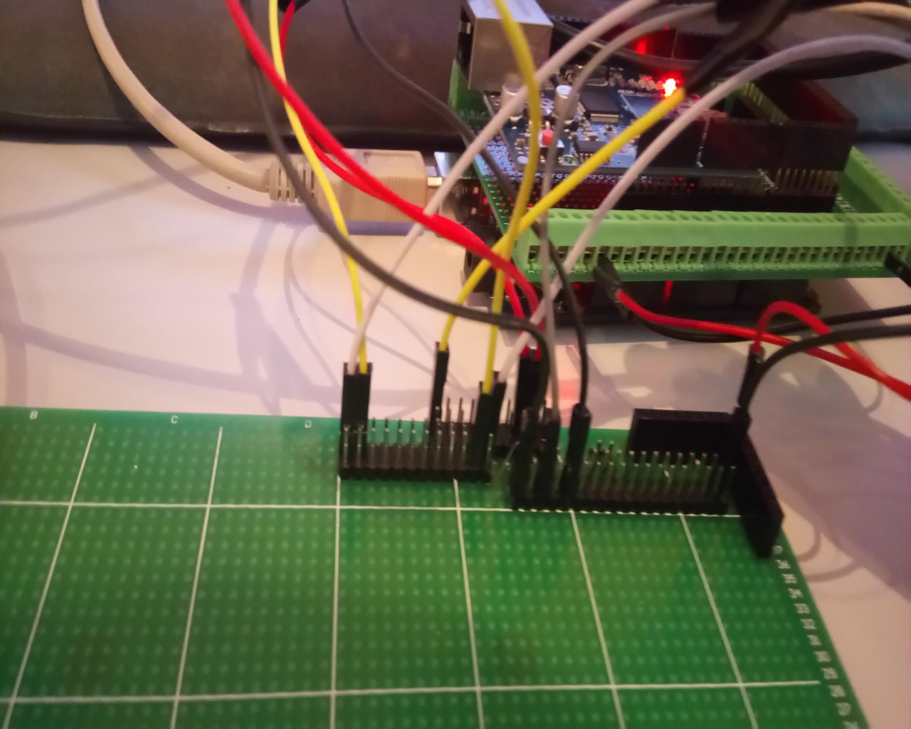

Today i started assembly arduino mega whith screw shield and ethernet shield:
I connected the temperature sensors and tested them. I decided to use a pcb board for the wirring. So far so good:

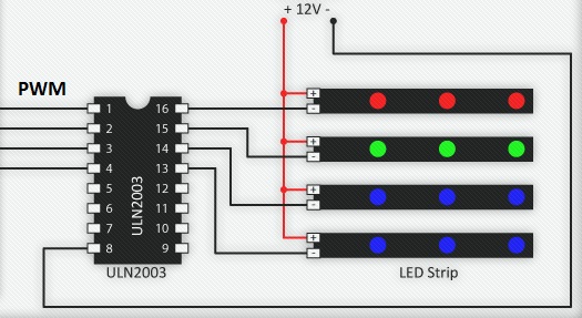

The more cheap and easy solution is a LED strip connected to an ULN 2003.
-------------------------------- Last edited Sun Mar 26, 2017 5:08 pm --------------------------------
The circuit is like this:
