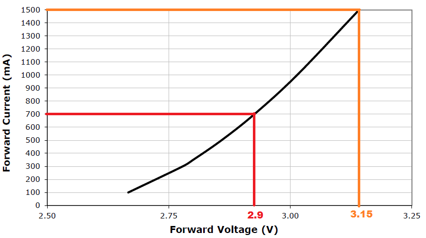

Now look on datasheet if green LEDs can work at 3,4@700 mA. Maybe you can join violet, cyan and green in a channel.
Here an example for XPE-G2.
It can work at 2.9 V @ 700 mA or 3.15 V @ 1500 mA.
