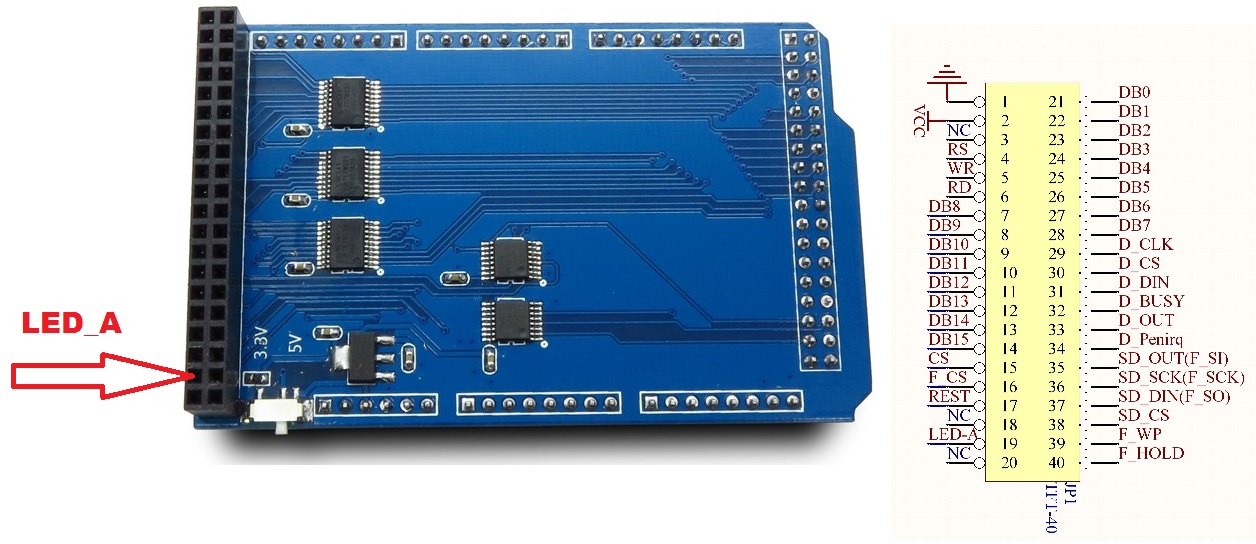

With the switch in 5V, check the voltage on pin "LED_A".

Post Number:#6 Post Thu Jul 17, 2014 4:57 pm
3.89 is too, should be 3.25 more or less.
You can cut the trail that goes to this pin and put the potentiometer as shown in the image above.

The problem should be on shield because the voltage is high on LED_A.
